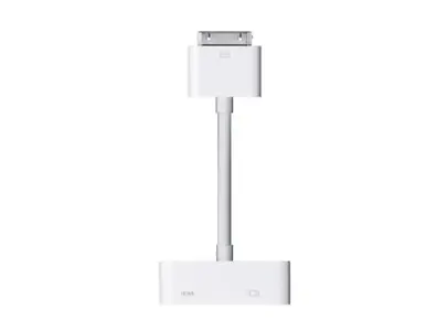

Hi Lynz - the cable adapter that I've used is shown below - has a docking end to the iPad and an HDMI input at the other end; plus, a USB connection for charging if needed; an HDMI cable is needed which will carry BOTH HD video and audio to your TV; of course the latter will need to have an HDMI input, and as already stated HDTVs have multiple inputs and the correct one needs to be selected to view your iPad on the TV.

Hi does that connection you pictured fit directly from iPad to tv and where do I get one? The cable I have fits my iPad and the RCA jacks fit tele but nothing that will fit the hdmi plug in my tv just has a USB on it aswell
First, you need the iPad adapter pictured above. You can get it anywhere that sells iPad accessories. Then, you need an HDMI cable. If your tv has an HDMI connection, then that's all you need.

As already stated, the iPad adapter that I own is from Apple (just check their store - plenty of other options offered) - an HDMI cable is needed which attaches to the adapter and then to an HDMI port on the TV (the cable needed is shown in the first link of the previous post) - appears that your TV does not have HDMI inputs (and USB is of no use).

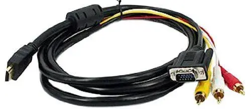

Now there are cables on the market (like the one below) which appear to convert an HDMI digital signal (like from the iPad) to analog composite video/audio (i.e. yellow,red,white RCA plugs; the other connector is VGA) - however, digital to analog conversion via just a wired connection is iffy at best (this cable was reviewed poorly on Amazon).
So, if your TV has ONLY RCA analog video/audio inputs, then as already stated, your best bet is to use the Apple iPad adapter (as shown in my post previously) w/ an HDMI cable plugged into a digital-analog convertor box w/ further composite cabling from that box to your TV (as shown in the second link in the other post) - just trying to reinforce the comments already made. Now if you go that route, i.e. convertor box, please check the reviews on Amazon - some seem to work well and others appear to function poorly.
