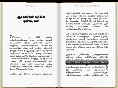

I have created one ePUB (TAMIL font embedded) and loaded in Ipad ibooks. It displays well but some word unwantedly broken and gives bad reading experience at the end of each line. (Refer attached screenshots)
So kindly help me how can i solve this issue.

I have found some solution to solve this this issue.
Change your actual content (i.e .html/.xhtml) into UNICODE text using UNICODE converter. This method solved the unwanted word break issues.
Note: Fonts not required for the UNICODE formatted ePub.
