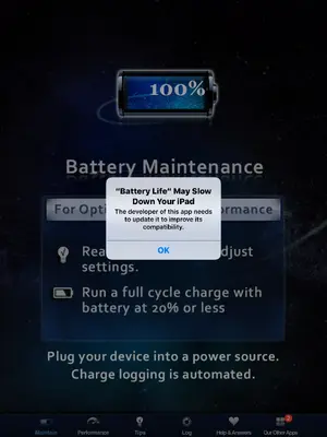

I recently started getting this popup when I launch an app. It has happened on different apps, not just this one. I never see any followup. Is my iPad at risk here? If so, what should I do? No update appears in the app store---or within the app.

Hello Tuttle - this is not malware, but actually a message from Apple put into iOS 10.x - I have the same battery app and get the identical popup (and have on other apps) - as stated, Apple is telling you that the app generating the message needs to be 'updated' by the developer to optimally interact w/ the newest iOS software - here is one Discussion. Dave :)

There is a way of finding out when each of your apps was last updated but it involves going to the listing for an app in the App Store and checking the description under version history for the last update date. This can be cumbersome if you have many apps on your iPhone. The quickest way of accessing the apps is to go to your purchase history in the App Store app and tap on an app icon, which opens the app listing. When you're finished with an app, tap on the page outside the box which dismisses it and you can then select the next app to check.
Thanks. What this does not show is whether the app is a 32 bit and would hence bring up the warning message, which is what I was after.
You're right about that but there's no way to tell directly which apps are 32 bit. An app that hasn't been updated for a few years is more likely to be a 32 bit app.
