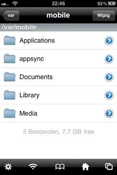

Step 3) - open iFile. When you open iFile you should see a screen like this:
Step 4) - With iFile open click on var in the top left corner, then click /
You are now in the root folder.
Click System then Library then PrivateFrameworks and then Celestial.framework.

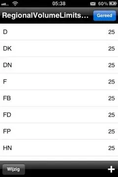

Step 5) - Click on Property List Viewer. Upon doing so you now have all of the volume settings for your iPhone, iPod Touch or iPad in front of you.
Change all the values in this file as shown above from 0,83 to 25. Which means setting the volume limit from 83% to 125%.
