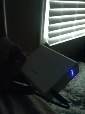

Mine looks like that but it's called poweradd
