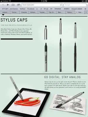

Just when you lost all hope someone came out with this stylus that attaches to a variety of pens plus it has a fine point.
http://more-real.com/
Cheers
My mistake, you are rift its not thin, I was to quick to post. As I understand the size is pre-determined because there needs to be a certain amount of contact for the screen to detect the input.
The nice thing about the "Cap" idea is that you can change the pen you are using so you have the most comfortable natural stylus around. And the tips are replaceable.
Back to the point. A quick google of fine tip stylus will show that a bunch of these are in the pipeline so I hope we see a good one soon.
