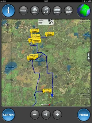

Here's a screenshot from a run I did a few weeks back. The blue line is my real time track.
Sent from my stock iPad 2

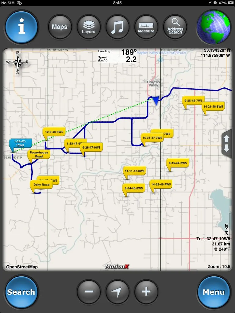

Here's the run I'm doing right now. The blue line shows my progress. The yellow waypoints are the places I've already set up, but haven't reached yet.
As you can see, there are different mapping options. The first screenshot was a winter road job, so I was more interested in the satellite image. This one shows the roads, and trails that I'm using.

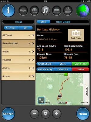

Here's a recorded track. It gives great detail, and saves the track when the real time track is erased.
