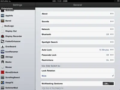

I attached a screenie :D of the extensions I have installed and no issues with barrel. Fyi...Winterboard is below switcherMod.
