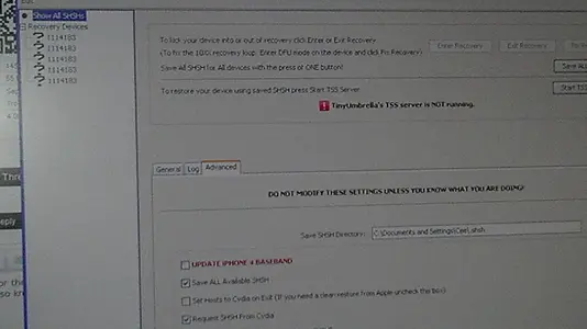

TU doesn't recognize my Ipad as being connected. It's logging it as a recovery device.
11/09/2011 18:25:32.328 Loaded History...
11/09/2011 18:26:01.953 Caching shsh files...
11/09/2011 18:26:01.953 Found [0] shsh files to cache...
11/09/2011 18:26:01.953 Cached [0] shsh files
11/09/2011 18:26:01.968 You are using the current version of TinyUmbrella.
11/09/2011 18:27:25.062 Recovery Device connected:
11/09/2011 18:28:46.000 Sending exit recovery request to 1114183
11/09/2011 18:28:46.203 Recovery Device disconnected: null
11/09/2011 18:28:55.718 Recovery Device connected:
So I seem to be getting stuck at step 1. Connecting.
