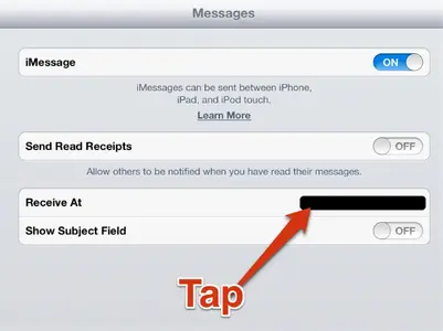

Go to Settings > Messages > Receive At, and see what Apple ID and additional email addresses you are receiving messages at. Sounds like you might have something incorrectly configured in there... Can you spot anything which is unusual?
Nothing unusual at all. One ID and it is my correct email address.

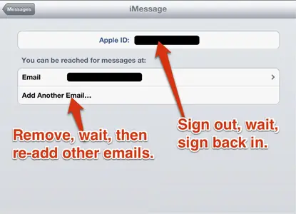

Might be a hiccup on Apple's iMessage servers. You can try re-setting your iPad's registration this way.
Go to the Messages settings and sign out of your account. Wait a while, then sign back in. This should remove and re-add your device's registration on Apple's iMessage servers.
Be sure to remove and re-add any extra email addresses you've got set up to receive as well. If iMessage is on, there will always be at least one email address. Do delete the last one, you have to add another; but I wouldn't bother doing this with your primary Apple ID email address. The sign in/out part should take care of it.
