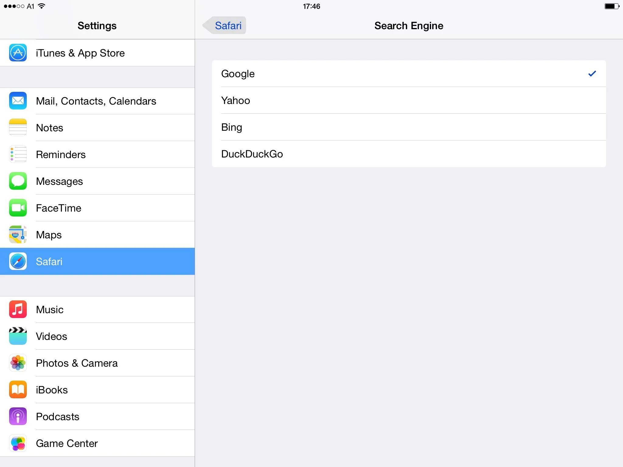

This is all I want to know, when I go to settings, safari, and the to the list of search engines. There in that list is, Google, bing, yahoo, and duck duck go. They each have check marks beside them. The one that is chosen, I think is the one with the blue check mark. This is what I am specifically talking about. If I were to select from that list duck duck go, then closed the settings, went back to home page, selected the icon Safari, I would think what would show up there, would be a search engine of duck duck go. And so on with choosing, yahoo, bing, and so on. But no matter what is chosen in that list, the only one that shows up, when and after I push the Safari icon is Google, even though that selection in the list was not chosen.
What is this list for if choosing one has no effect.
There must be a glitch in your settings. Only one of the serach engines should have a check mark, the one you chose:

I only have one check mark, and that is the blue check, I thought that the others had light gray checks, but as I checked they do not.
This being said what have you to say about this, is this just the way it is or what?
If I have yahoo checked, where would I go to see that yahoo search engine had been chosen?
Or is my thinking about what this all is about and how it should work completely wrong.
