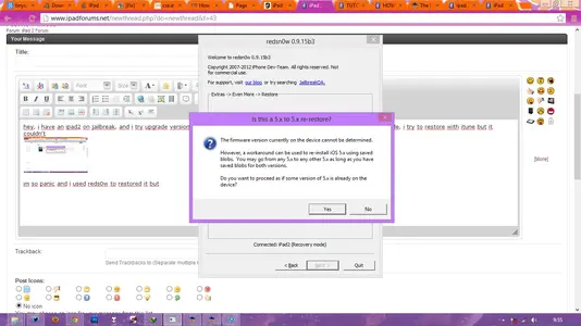

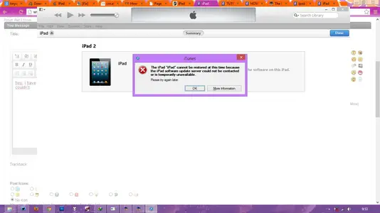

hey, i have an ipad2 on jailbreak, and i try upgrade version of my ios from 5.1.1 to 6.1.3 but my ipad broke and go to recovery mode, i try to restore with itune but it couldn't

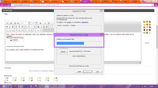

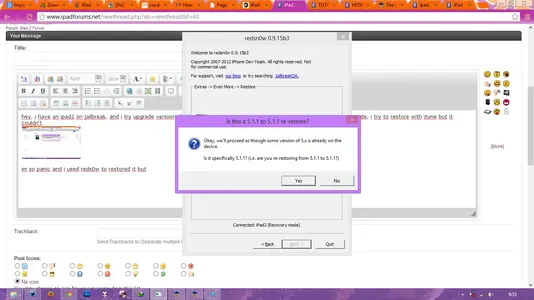

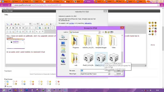

im so panic and i used reds0w to restored it but

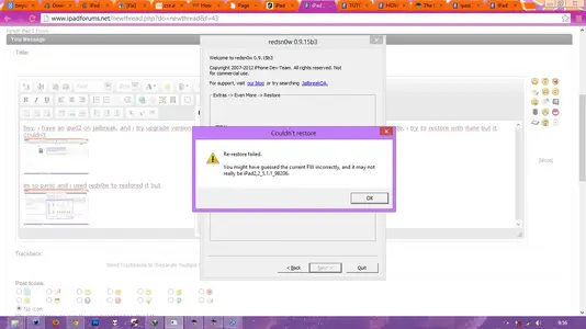

but it says RE-restore failed

(2) If you are trying to re-restore iOS 5.1.1 onto that iPad - do you have SHSH blobs for that iOS? Because the re-restore will not work if you don't have the blobs.

i tried it many times, but couldn't, i was downloaded the 6.1.3 ipsw and i use shift+restore but didn't work
do you have any solution??? pleaseee :(
Well you have TinyUmbrella running (twice by the looks of it). You won't be able to restore your device properly whilst it is running. Go to the Advanced Tab in TU and make sure you have "Request SHSH from Cydia" UNTICKED. That is very important. Then you must QUIT TinyUmbrella.
Try the restore in iTunes again after that and you should be OK.
