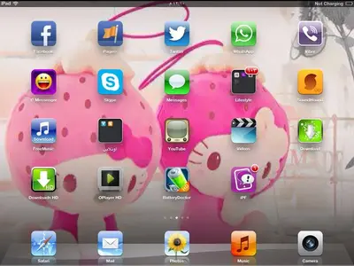

HiI Im a new ipad user ,, Im recently (( for two days)) facing a new problem when plogg my ipad to the wall outlet adapter it show no charging sign ,,, I left my ipad all the night at the morning noticed that it chargeed 30% ,, but it so slowly ,, when I turned the ipad off to charged it .. It will automatically turned on and show no charging sign again
Please help me Im so disappoint I need the ipad in my study since Im a pharmacy student please help me quickly. ...

Are you using the cable that came with your iPad? As other cables like the one for an iPhone will only trickle charge the iPad.
Yes im using the orginal one that come with the ipad ,, I also replace the cable with iphone cable ... The same problem
I also use ipad charger to charge iphone it charge with out any issue
An iPhone charger will only trickle charge an iPad but you can use the iPad charger for your iPhone.
I was going to suggest using a different outlet but seeing as it is charging albeit very slowly it doesn't appear to be this.
Reset your iPad and see if this makes a difference. This will not change anything on your iPad and is akin to rebooting a pc.
Reset - Hold the power off button and the home button simultaneously, keep holding them in and you may see the power off slide appear and disappear, wait until you see the Apple logo appear before releasing the buttons. It will take a little longer for your iPad to start.
Let us know how you go.
I do that yesterday more than one time .... Nothing change
Also tried setting .. General ...Reset ... Reset all setting ... Nothing change
Can it be a battery virus?
No it won't be a virus.....might just be the charger or the port on your iPad. How old is your iPad?
Have a look at the port to make sure nothing has lodged here, don't go sticking anything in there though. If there is something there, be very careful removing it, I have heard of others using a vacuum even.
Your iPad may have a defective battery. Is there an Apple Store near you? The staff there can run a diagnostic to determine what the problem is.
Thanx for your helping ... There is nothing wrong with the port its as new as the first time
I bought it a month & half ago
As your iPad is new and under Warranty I would do what the Admiral suggests and take it into Apple. Make an appointment with the Genius Bar and do a full backup of your iPad before you go, as they will most likely just swap it for another.
