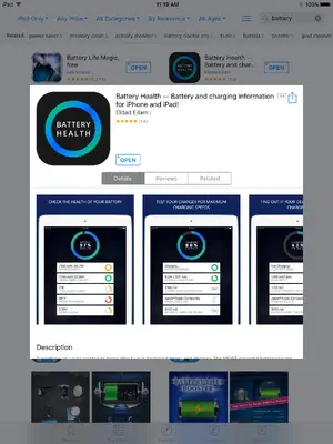

Hello - your iPad 2 was released in 2011, now approaching 5 years of age - Li-Ion batteries age - not sure 'how old' the one in your device may be depending on its date of production - please follow the previous excellent suggestions - if you are still having a problem, then you might want to obtain one of a number of apps that can measure your iPad's battery status - one is Battery Health, available in the iPad app store - see pic below and connected red arrow which gives the over health of the battery (just a ratio of the two amperages immediately below) and the number of cycles your battery has experienced - at 1000 cycles your battery should maintain only 80% or less of it original capacity.
