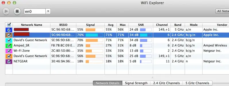

Hi & welcome to the forum! :) First let us know if your iPad 2 is Wi-Fi only or also cellular; if so, which signal are you trying to use on the device. Second, there are programs, such as Wi-Fi Explorer & iStumbler that can be put on your laptop and will measure signal strength and SNR (signal to noise ratio). Dave

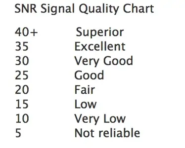

Now, for signal strength, I use Wi-Fi Explorer on my Mac laptop which provides abundant information about my home network (and my neighbor's - not an issue since we all are on WPA2 security) - see the pics below; my MBPro is currently using the 2.4 GHz band w/ a 70% signal strength and 34 Db SNR which is excellent according to the chart attached - those are the numbers needed from an iPad if an app existed to obtain them? Hope this helps - Dave
