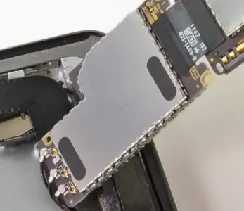

If you want it repaired it will need opening, it could be as easy as one of the 3 antenna cables have come off the cellular module, heres a pic of one ive got open showing the 3 antenna sockets and a pic and one IMG_0272.JPG fSmCZhbWjW32eHRT.jpg with the cables connected from a public domain
The module is conntected to the logic board by a flimsy tab glued down with a conductive tape (fine particles of copper in a paste/tape) IMG_0273.JPG
this can also easily lift off with heat or not connect properly. there are a number of things. But from your recent post it sounds like its nothing can be sorted at your apple store

I shall see what Apple says next week. I have mixed experience of the Genius Bar, having used them once for an iMac problem and once for an eMac problem. For the iMac they were very helpful and for the eMac they told me that what I wanted to do was "impossible" - it wasn't (unlock password protected firmware without knowing the password). It wasn't easy, but I did it.
If they prove unhelpful, I shall return to the Apple Repairer who was reluctant to open the case without Apple seeing it first. He didn't want to open it, fail to remedy the fault, and then have me to go to Apple and have them refuse to help because it had been opened. That sort of integrity is not common and gives me confidence in him if Apple don't come up with the goods!
Thanks for the pictures, it will give me some idea of what to say when I speak to them face to face.
