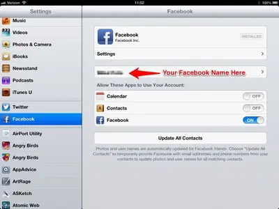

Go to Settings > Facebook. Make sure your account information is set. Be sure to turn off the Calendar and Contacts options if you don't want you Facebook stuff showing up in those apps.
This is what the iPad uses to share to FaceBook in other apps and at the top of the notification bar.

I have the same issue but Facebook is not listed in settings. I definitely have the app on the desktop though.
The FaceBook integration shown here is a part of iOS 6. If you have not updated to iOS 6 (or can't) then you'll have to manage your sign in settings from within the app itself.
Open the app and tap the icon with three parallel lines at the top left (so that you seed the sidebar). Scroll to the very bottom of the sidebar, where you will see either a Log Out or In option.
Note: For those using iOS 6 and who have FaceBook setup in Settings > FaceBook, it won't let you stay logged out. You'll have to delete your account in Settings > FaceBook to do that.
