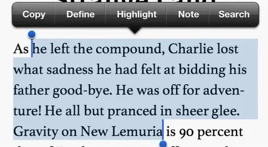

The issue is not the iOS, but whether the book has DRM (Digital Rights Management).
If the book is protected with DRM, then the Copy option does not appear. ePub books without DRM will let you copy text.
I took this screenshot from iOS 6 iBooks using a non-DRM book.
