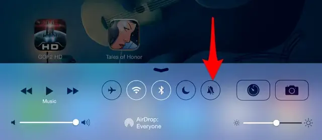

You didn't say whether you checked the Control Panel to see if Mute is on there. If the side switch is set to Lock Rotation, the mute control will be in the Control Panel. Swipe up from the 'bottom edge' of the screen to see the Control Panel. The Mute on/off will be bell in a circle icon. Highlighted (white) is on.
Depending on your settings the Control Panel can be available from most screens (lock, home, or in app), but it is always available when you are viewing a Home screen.
Edit: Adding a screenshot.
