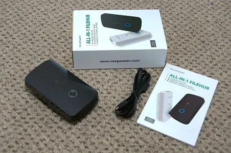

So what exactly is a FileHub? In short, this is a device that serves up the content from a USB drive or SD card via a personal Wifi hotspot. I have the first version of the Filehub from RAVPower but this new model differs in functionality in that it also includes an Ethernet port that can turn a wired connection into a Wi-Fi access point. It also has twice the battery capacity and twice the amount of anything is usually a good thing!
Included in the box is the unit itself, a micro usb charging cable and user guide. There is no charger included but since any USB charger or port can be used as a power source to charge the internal battery, this is no great hardship.
This unit is a different design and layout from the first generation however the build quality and portability remain as I would expect. It is well finished and feels very sturdy indeed, no doubt enhanced by the fact the majority of internal space is filled by the lithium polymer battery. While no case is included in the package, I can see this device standing up to regular but careful use.
This measures in at 98 x 53 x 28 mm and weighs 155g. On the top you have four LEDs indicating battery charge and a further LED for WiFi status. The illuminated power button is also located on the top with a reset button and micro USB port for charging on one side. One end hosts Ethernet and USB ports under a protective rubber cover while the opposite features a full sized SD slot which supports SD, SDHC & SDXC cards.
The FileHub is powered up by using the power button and takes around 25 seconds to start up and be accessible via Wifi. Given it has to start up its internal router as well as scan the media source and advertise data, I find it to be more than acceptable.
When the device is ready, you should be able to find it's Wifi signal if you search on your client device. For this review, I am using an iPad but it should work with any Wifi enabled device including tablets, smart phones, laptops etc. When you first connect to this Wifi connection, you will be prompted for a password which is 11111111. Once you have entered this password, it will be stored on your device so subsequent connections should be automatic. Indeed, in my testing, this proved to be the case and no further user involvement was required other than switching between Wifi networks as required. While I would typically get more use of a device like this when travelling, you do have the option of a network pass through or bridge. This means if you are using it at home, you can connect the FileHub to your home Internet connection and connect your device to the FileHub. This way you have access to the content on the FileHub as well as still having full access to the Internet without the need to switch network connections. This would also work just the same in a hotel room if using the Hotel's Wifi Internet connection. If you only have access to a wired connection, the Filehub can use its Ethernet connection to turn this into a Wireless network for convenience or for Wifi only devices such as phones, tablets and ultrabooks.
Now that you are connected to the FileHub, you need a way of interacting with it and you have a few options. There is a free dedicated app for IOS & Android which lets you browse connected media, playback supported formats, manage content and also some basic configuration of the FileHub. The Filehub Plus app for IOS is universal and is handy depending on how you intend to use your FileHub but not a requirement. One of the primary uses for me is media playback, especially movies when travelling and my collection contains various formats that are not natively supported by IOS and therefore nor by the Filehub app; at least it appears this way. If you encounter such media, you can use the Filehub app to download it to your IOS device instead and then use the 'Open in' feature to open this with a media player that supports the format you are trying to playback. Strangely though, when I tried playing back the likes of a MKV video file, it played back without issue so the app does indeed support addition formats over and above what native iOS does. My personal favourite for thirs party apps though is the universal nPlayer which can connect via uPNP or SMB protocols and either stream or download files from the FileHub. Searching for SMB shares using nPlayer did show up the FileHub however I could not access any files. A quick look at the user guide showed the FileHub using its own IP address of 10.10.10.254 and it has a default admin account labelled 'admin' with no password. Knowing this was some form of authentication issue, I went back to the user guide and saw I could pull up the FileHub's full admin applet using a connected browser. I entered the IP address into the iPad's browser and immediately connected to the admin web server running on the FileHub. From here I could set a password for the default admin account. This web configuration page actually gives you full control over the FileHub and I recommend using this for initial set up. I now went back to nPlayer and connected using this new password. From here on I had full access to the media on the FileHub and could stream and download without any issue. While this issue may be related to how nPlayer works with SMB I would bare this information in mind. If you have issues with a third party application accessing the FileHub over SMB, ensure you use 'admin' as the user and set a password using the web configuration. If you choose to use the DLNA or uPNP protocol instead, there were no such issues however only items in folders served up by the DLNA server on the Filehub could be accessed. Folders for DLNA can be changed or added to using the web server connection when setting up services on the Filehub.
