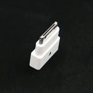

Hi,
The docking/charging port on my iPad 1 has become faulty (wear and tear). I've found the replacement part I need for £30 on eBay a repair guide online.
Obviously I'll need to get some Spluggers? (Is that an American term) and torx driver, but they're cheap.
My question is it difficult to open an iPad?
I've changed the e-ink screen on my Kindle so have some experience.
PS
It's out of warranty
