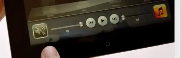

This problem should come from iOS core, but for now you can solve by
1. Settings --> General --> Use side switch to: --> select "Lock Rotation"
2. open you apps which not display sound
3. double click home button see picture
4. click un-mute on icon sound
5. open you apps again, it should heart sound now.
