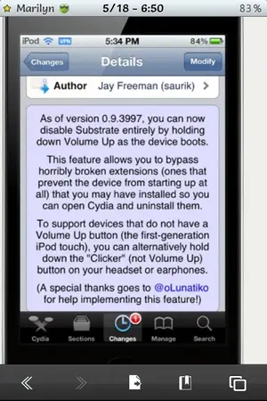

Here, specifically, are the steps to activate Safe Mode (it's a picture directly from the developer, saurik):

YOU ARE AN ABSOLUTE GENIUS! THANK YOU, THANK YOU, THANK YOU! Got back into my iPad after entering Safe Mode per your excellent instructions! Removed that app and all appears to be working fine! Can't thank you enough. So glad I didn't panic and restore it!
Yay! Glad it worked out for you. And yes, I'm glad that you didn't lose your jail break.
But, the biggest thanks go to saurik (aka Jay Freeman) for updating Mobile Substrate so people have a way to get into Safe Mode. It definitely is a jail break saver as you have discovered. :)
