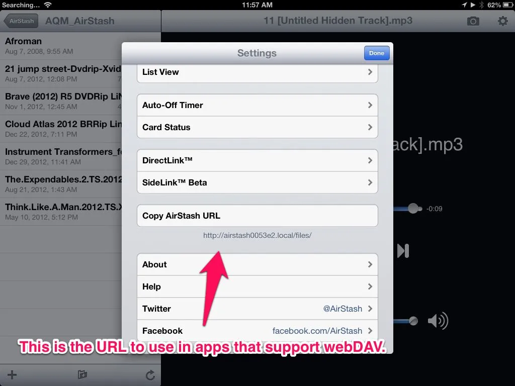

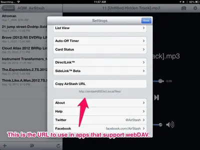

It's been a while since I updated this thread...but there is a new feature to the Air Stash+ that is worth reporting on.
It is called SideLink (which I believe is currently in beta, even though the website indicated the beta is closed). Anywho, using this feature means you can create a link to the Air Stash+, and access its storage from your iPad, while also being connected to your wifi, so you can use the internet while using the Air Stash! Without Sidelink, you have to log into the Air Stash+ webserver, which meant you could not be on another wifi, so while you could stream from the Air Stash, you could not surf the web. With Sidelink, you can stream music in the background on your iPad while using another application. You can stream music, work on a doc in Pages, then save your work to the Air Stash, and then jump on Amazon.com, while without having to bother with changing up your wifi. It is a nice improvement that saves a bunch as hassle and make the device much nicer to use.
There is a change that results from using Sidelink. If you use an app that supports WebDAV, like the iLife suite of apps, then you need to use a certain URL in those apps to read/save from the Air Stash. That pretty much it once you work through the details of getting Sidelink set up (and the iOS Air Stash app provides the instructions you need).
