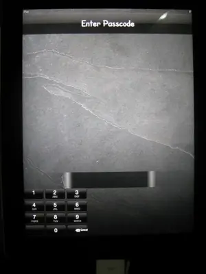

iPad comes back to the 'slide to unlock' and looks fine until I slide it - then it looks like this...

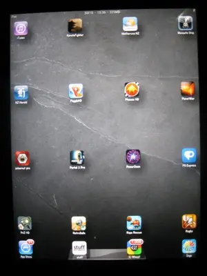

And then once unlocked all the icons have been resized to some weird smaller size and have been spread out on many more pages of icons than I had originally. Also the bottom docked icons have changed and now there are only 4 instead of 6...

Okay, the first thing is - from SBSettings, can you either
1) Press More, then Respring to see if the iPad goes back to normal
Or, if that didn't help
2) Select More and then select Safe Mode. This will allow most of the iPad "hinkiness" to stop so that you can get back to Cydia and uninstall one (or more) of those tweaks you just updated.
TBH, I'm hoping #1 works for you, because none of those tweaks you listed should have caused you troubles.
So, try the respring or the safe mode options. If you can get either to make the iPad appear normal, you'll be almost fine. Then, we can figure out how to get you to 100%.
Please see if this helps and let us know how you are doing.

Marilyn, you are a legend!!! Respring worked and all is well - oh so lucky to have SBSettings installed I guess. Wish I knew what sent it crazy... was having major palpitations that I was gonna end up on iOS 5 and waiting for a JB for an aeon (well it felt like an aeon waiting last time!!!).
I can't figure out which of my cydia apps/tweaks were actually updated today... so it may be difficult to troubleshoot what went wrong.
