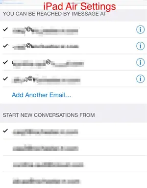

Marilyn,
Here are my settings. I have used Skitch and labeled them to show which is the pad setting and which is the phone setting. I pixels them but left enough to show which are email addresses and which are phone numbers.
My iPad will not allow me to,use my phone number. I figured it was because it is not a phone, or I am doing something wrong.
I can't add my phone number to settings on the iPad Air, although in contacts the little text bubble icon shows up beside the phone number beside my contact info. Clicking to add another email, is just that. It will only allow me to add another email address.
Other than the phone being on the phone and not on the pad, they are the same.
I found the answer to my iMessage issue. Rather than put the solution at the end, I will put it here and then the explanation after so if you need to just fix your iMessage you don't have to read this whole thing unless you want more info.
If your iMessage is no longer using your cell phone number, or simply not working properly, go to Settings/iMessages. Click the Apple ID Box that has the email address and sign out. Exit out and go back there and sign back in and follow the prompts. For more info read on. This is the quick and dirty explanation.
My thinking was, if it isn't working to just start over. It worked.
Apparently, when it was updated, or when I changed the password to my Apple ID, the settings for the iMessage were changed because it is now back to what it was when I had started from the get go. I figured I would start over from scratch. Here is what I did.
I went to the iMessages in Settings. Clicked the option for send and receive list. I then clicked my Apple ID account section and signed out. I then closed settings and went back into settings. Then I signed in and entered the information to sign in. I was hoping it would ask for the information as to how I wanted to be contacted by others and start a conversation. It did not. Furthermore, there was no option to go back or to continue. Basically no way to exit that screen so I pressed the home key.
I went back into settings. I selected the iMessage and then to add the send and receive info. It asked me for my Apple ID info, which I did. All of a sudden, my phone number was there with the check mark and so were the email addresses. I didn't have to re-enter them.
Take note: It seems to default to your iCloud address for starting a new conversation every time you do anything (or at least updating or signing out/in), so I changed it to what I want to use. If you ever make changes to the iMessage or update your phone, as a precaution, check your iMessages to see if the option for how you want to start a conversation has changed. I then checked my iPad and lo and behold, it is back to where it was from the get to. My phone is listed as an option to receive with along with some email addresses and all are checked. The phone number is also the option that is checked for starting a conversation.
