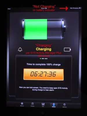

When charging using USB 3.0 from my HP DV7 laptop:
  • SYS Activity Manager Plus indicates that it IS Charging
  • The screen battery indicator says "Not Charging"
SYS Activity Manager Plus (for Memory, Processes, Disk, Battery, Network, Device Stat & Performance Monitoring) is one of the relatively few paid apps that I have bought yet (and well worth the 99 cents).

Hmmm. Interesting. Does the battery percentage increase over time?
To answer your question, I did an experiment.
I plugged my New iPad with 64% battery life indicated into my USB 3.0 port. I changed the power settings on my laptop to not 'go to Sleep'.
After 5 hours charging on USB 3.0, the Battery Indicator showed 79% (or an increase of 3% per hour).
So, a very rough estimate of how long a full charge would take is 30 to 33 hours.
Conclusions:
  • Recharging on USB 3.0 is slow (no surprise)
  • SYS Activity Manager Plus' estimated recharge time is not correct for USB 3.0 charging (no surprise)
