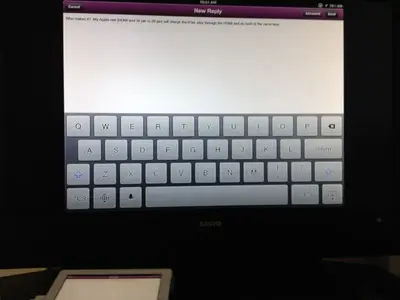

Who makes it? My Apple one (HDMI and 30 pin to 30 pin) will charge the iPad, play through the HDMI and do both at the same time. I just took a pic with my phone and will edit this to add the picture
Edit: to add picture
