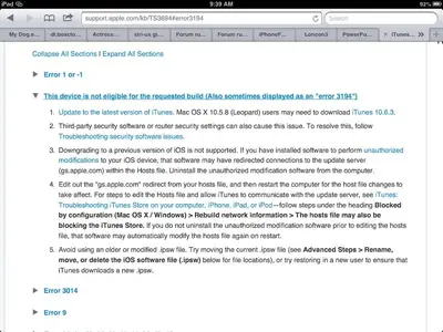

Have you been trying to download an older version of iOS on to your iPad? Try looking at this site.http://support.apple.com/kb/TS3694#error21
First off i don't know what firmware was on ipad. And i seen on web that 5.1 was the latest firmware so thats the one i been trying to install. but i keep getting error 3194. and ipad doesn't lite up at all. so i'm going to get a new battery for it and go from there.
What firmware should i be trying to install if i don't know what on it .
