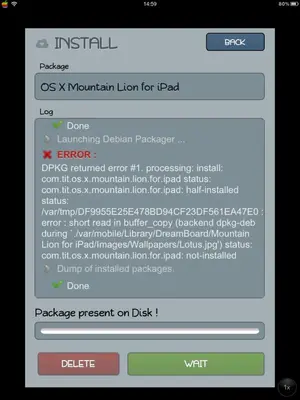

Having issues installing this theme on my iPad 3 after purchasing straight from the theme it app via pay pal. Have un installed the app and re installed but still all I get is this... Any help??

Sorry, not ignoring you. I just don't use Dreamboard on my iPad.
The only suggestion I can offer is to contact the theme developer and see if they can assist. Sorry.
Marilyn
Thank you for replying any way. I don't usually use dreamboard either but really wanted to try this out. I contacted the developer already and nothing.. Suppose I'll just wait and see if I get a reply at all.

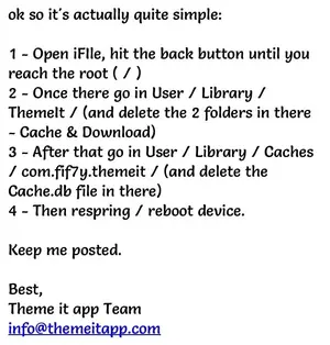

For anybody else who experiences this problem with the theme it app, here's how to fix it.. There support via the app is excellent and helped me fix the problem within 24 hours of contacting them
Here's what to do:

Oh, yay! I am glad that (1) the developer helped and (2) you got it to work. So, do you like it? Sometimes, I'm tempted to try Dreamboard again on the iPad...
And, thanks for this fix. It was good of you to come back and post the solution. 'Preciate it.
