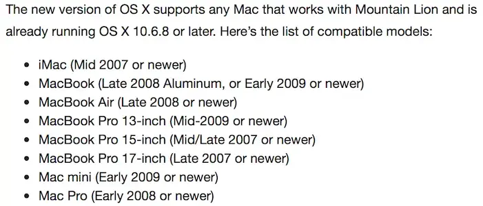

1. Macbook Pro 2007 vintage - 'ancient' machine (computers last like 'dog years') - have you checked compatibility (model/RAM/free disk space, etc.) w/ nthe installation needs of Mavericks? I don't know but from the attachment below (click to enlarge), you MBPro seems on the edge of being obsolete? BTW - source HERE - take a look.

1.thanks for the reply - According to the specs i should be able to run Mavericks as cover everything thats needed , i would love to buy a new computer but there is nothing wrong with this one , just apple software not working when update ipad and not computer is problem..
