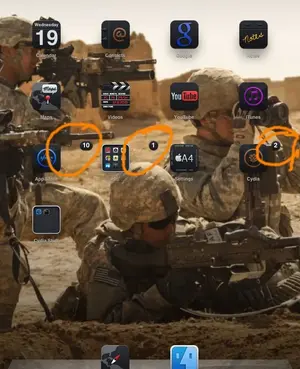

Hi all,
On my springboard the notification numbers of my apps are floating. they move away from the icon. Help??

O ya imm srry i forgot to also mention that the numbers float away sometimes. Somtimes when i open an app and quit back the the maon screen the numbers are normal. Then when i open another app and quit it, it starts floating again.

Hey guys. Not home yet but I managed tovreproduce the problem on my cousins iPad. The problem was the cydia tweak "Barrel". Thanks anyways guys
Thanks for the update. Barrel acted hinky on my iPad, also. Works for some people, though...

it happened to me as well .. i just respringed my winterboard and the apps' number notifications just back repositioned itself ,,, mine on ipad 3g wifi on 4.3.3
@Mickey No problem anything for u guys who help me too!
@nammi same here but after i used my ipad for like an hour the numbers moved again. and i wont respring every hour...
so far so good me , Vaib .. just hv to respringed it once .. i'll take note of yr solution in case it happened again .. :)
