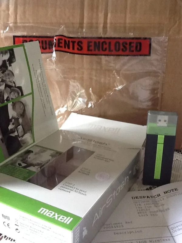

Well as I said just keeping up to date with the air stash, it came yesterday ,i was out ,I picked it up this morning on the ticket wouldn't go though the letter box.what do you recon?
Are you having a problem with it?
No just me trying to confuse myself and everybody else as well I think. I am making a very good job of that at least
