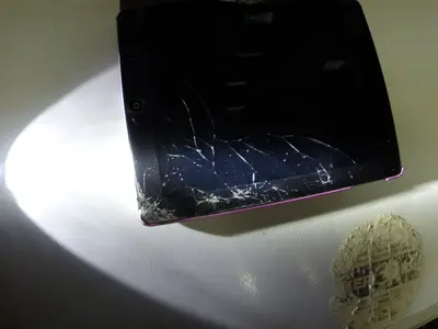

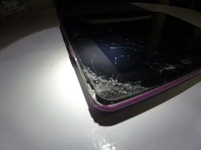

Hey,
My Mother recently dropped her iPad out of their truck and cracked the screen and dented the case a little in the corner. We got her a new one for her birthday and now I got the old one, I was gonna fix it for my nephew and was not sure what to order for it. It is a Model A1458, 4th generation I presume. I would get it repaired but that is crazy expensive for the model. We paid $80 more for the brand new iPad Air over the repair cost(refurbished iPad) of a 4th generation iPad.
I am wondering what parts I will need? The iPad works fine, all buttons still work, the glass is being held in by a screen protector because it is 30% shattered into a spider web. The corner got a little dent in the aluminum case but does not look like it will interfere with a reinstall. Do I need the rubber gasket that I can see a little of now or is that salvageable? It does not look harmed, yet. Tell me what I need and some links to them would be great!
Reading the reviews of the DIY kits they all got good and bad reviews, does anyone have any experience with them and what one should I buy? I got no glass removal tools except for the heat gun, so a kit with good tools would be best!
A couple of pics attached to see the damage. They did not come out the best, dang gopro, but hopefully you can see what is going on there.
Thanks for any help,
Flint!

If you haven't already seen them, these are the fees Apple charges to repair the screen on an iPad. Bear in mind though, that if you have Apple do the repair, they'll also replace the case. iPad Screen Damage Repair - Apple Support
If you want to do the repair yourself, ifixit.com has video tutorials for almost any kind of iPad repair. They also sell genuine replacement parts and the tools necessary for the job.
Definitely go to iFixit.com. Avoid the Amazon and ebay kits as they are crap. In regards to the "Rubber Gasket" it is just a small plastic subframe. If you remove the old glass carefully enough you should be able to salvage it.
