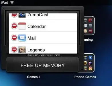

So then, if apps are staying in RAM what happens when there is no more RAM and you are trying to open another app, which is not in RAM? Well in theory iOS should efficiently close anything it needs to in order to run the foreground application.
But in practice this does not always work, especially when trying to load a memory-intensive app. iOS may "think" it has enough RAM for the currently loading app but the app actually needs more. Boom. It crashes or does not function properly. This is what was happening in the Netflix example given previously by DaveSt. So closing apps in memory will free up RAM and let Netflix run properly.
Unfortunately iOS doesn't make it easy to know what is actually running. So you have to just close whatever is out there. This of course takes the app out of the switcher too, and I personally like having my recently used apps there. So since I am jailbroken I use SBSettings to close out apps if for some reason I am having trouble getting a large app to load. I don't make a habit out of it, because usually iOS is able to do the job OK on its own, but it's nice to be able to see what is going on and close apps if I need to.
The apps in the pic below were currently loaded in RAM when the screen shot was taken. BUT, those apps were NOT the first apps in the task switcher bar. So if I just went and closed the first few apps in the switcher it would not have freed any RAM.

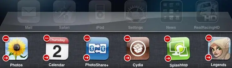

I would love to see an icon at the start of the list of running apps that lets you close everything in one go instead of closing them all down one at a time.
I would have hoped we had that functionality but alas Apple chose not to do it. I do, however, use a jailbreak app that adds to the functionality of the task switcher. SwitcherPlus, among other cool features, adds a "->" icon along with the usual "-" icon--when you tap and hold an app in the switcher bar. Tapping the "->" icon will close that app, as well as all the apps to the right of it. So if I want to quickly clean out the list I just do it to the first app there... and presto, they are all cleared out. But I don't often do this as I do like having a list of recently used apps handy... and I as I mentioned in previous post I close apps using SBSettings--which does not remove it from the switcher bar.
