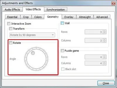

Anyway, VLC does have a rotate option.
You can find it in Tools > Effects and Filters.
Then there, select the Video Effects tab at the top of the box, and then the Geometry tab underneath.

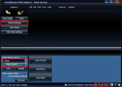

start the program, and enable the "Power User" checkmark and go into Global Settings.

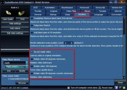

then go into the "borders" tab, and near the bottom you will find rotation options:
after that, just drag your videos over and start a conversion.
After the conversion, the video will be oriented properly, and regardless of the player you use, it will display as intended.
