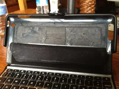

Here are some photos of my tweak to partially remove the Foam Pad on the ZAGGfolio version "1" for the iPad 2.
Above is a picture of the felt lining on the iPad side that I "Gently" pulled up to reveal the foam pad. I removed two inches or so on either side and left a 1.5 x 1.5 inch strip in the center.

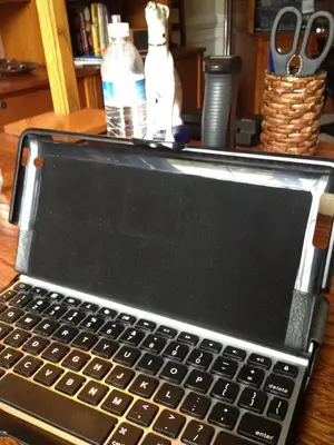

This is a picture of the felt lining reapplied. The adhesive is very sticky and it laid right back.
The New iPad now slips in and out with no problems. The remaining pad has just enough resistance, to hold the iPad in place so it doesn't slide out by accident.
