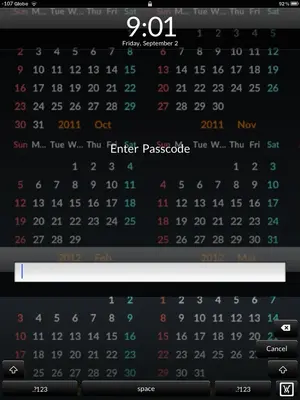

does anyone know what causes this, the keyboard losing all its letters, in safe mode? and how to get the keyboard back?
it's impossible to use the ipad in 'safe mode' when my lock password is set as an alpha-numeric string.
i have the 5-row keyboard installed, but it works perfectly after a reboot.
5 row had a bug with ifile and caused the keyboard to look just like that. But the keyboard worked fine everywhere but ifile. So, maybe 5 row is clashing with something else. Uninstall 5 row for now and see what happens.
I, too, have a wonky looking keyboard in safe mode. I figure it's because 5-Row Keyboard is tied both into the system and into WinterBoard. So, Safe Mode shuts 1/2 of the keyboard off...
However, I don't have my iPad passworded - so I can go to Settings and remove 5-Row from the Keyboard area. Then, my keyboard is fine.
But, I can't think of a way that you can get around the necessity to enter the password. I guess the only "solution" is for you to decide which you want - 5-Row Keyboard or a password.

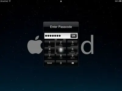

If you go with a more than 4 digit password, it must be all numbers or the iPad will use the keyboard. See my screenshot.
thanks, graywolf. i tried it again and it works, using 9 digits.
