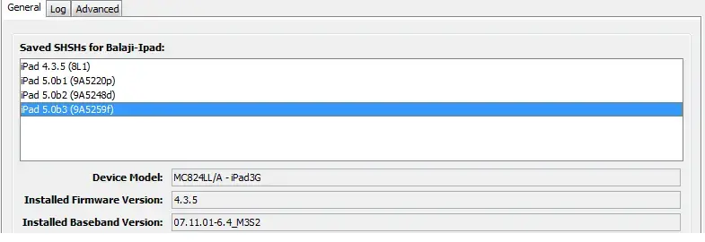

Hi All
I have Ipad1, i have jailbreak using redsnow sometime back may be year+ old
iam running 4.3.5 tethered, iam bored of rebooting every time with redsnow. now i would like to upgrade untethered 5.0.1
so that i can off and on with out any software reboot.
i started TU to look my sshh blobs.
i did not see 5.0.1 blobs, so can some one suggest me, how can i upgrade or get 5.0.1 blobs and upgrade to 5.0.1 OS, and jailbreak using redsnow.
thanks and appreciate for the help in advance
Ram
talk2ram said:
Hi All
<img src="http://www.ipadforums.net/attachment.php?attachmentid=14282"/>
Ram
Sorry, but if you don't have blobs for 5.0.1 (and that screenshot would appear to say you don't) then there is nothing you can do. Your only choice is to go to 5.1, but that too is TETHERED.
